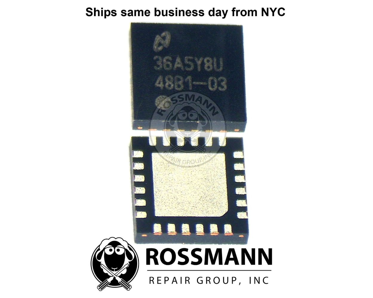

LP8548B1SQ U7701 U7700
This is the LED driver for certain Retina Macbook Pros. It controls the DC to DC boost circuit that turns 12v into 26-39v for your laptop's screen light. If you want the surrounding resistors & diodes for different board types, look below!
