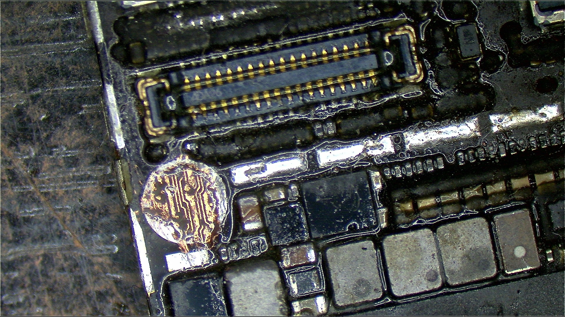

Some phones get tossed in the toilet. Some break during repair attempts, or from being exposed to rainwater. Either way, even iPhone motherboards as destroyed as the iPhone below have been repaired right here at our store!

We use the same techniques utilized for our component level logic board repairs to retrieve data from your iPhone, and you only pay if we get your data.
We properly treat your phone's logic board.
Your phone's logic board is comprised of components covered by shields. If your phone is damaged by water, it is often for cellphone repair shops to attempt a cleaning of the phone. The problem is most do not remove the shields. If these are not removed, the corrosion and damage sitting under the shields will not be addressed. Liquid damage on electronic circuit boards is a degenerative process that gets worse and worse. The longer one attempts to power the device on with this corrosion present, the worse it gets. We address this prior to any other component level repairs on the logic board with an ultrasonic cleaning process that removes the corrosion from the entire logic board. Think of cleaning a phone without desoldering its shields like taking a shower with your clothes on. It doesn't work, yet, for some reason, it is the most commonly advertised treatment.
We do not fix liquid damaged phones to be used again; only to recover data.
If your phone has been liquid damaged, Apple will replace the device outright for $200-$300 - even if you are not in warranty. Add up a $25 battery, $84 screen, $25 in flex cables, $150-$300 in motherboard repair, and $40 in disassembly/reassembly work, and it makes no sense. We do not provide liquid damage repairs to liquid damaged cellphones. It makes far more sense to go to Apple and have them give you another phone via their out of warranty programs..
